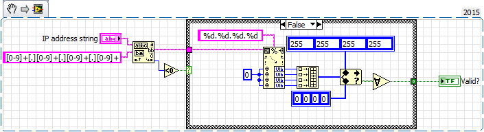

I use a string control and error check it like this:
=== Engineer Ambiguously ===
