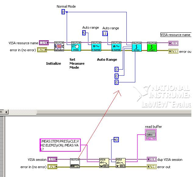

I download the driver from
http://sine.ni.com/apps/utf8/niid_web_display.model_page?p_model_id=1805
I select Plug and Play (project-style) and run the sample vi from the above link.
and use the programe to get the frequency. It returns a error reading, for example 0.999xe-6.freq.JPG
(2,837 Views)
It cannot read the frequency value from element 2 and 3 (if element 1 frequency shows on the display).  Can anyone suggest me a command which can get the frequency by programe not display?
Thank you.
(2,830 Views)
st168,
I have not tried reading the frequency while the integration is running.  I would start by removing the Integrate functionality and focus on just reading the frequency.
