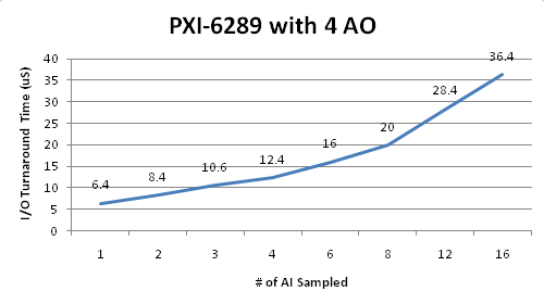

In the DAQ configurations I tried a variety of AI and 4 AO, as it is easy to rapidly change my # of AI. I made a graph of the DAQ timing. A timed sequence was used with a while loop inside so I could do processor assignment and avoid interrupts. The code blocked on the DAQmx Read which was set to polling mode through a DAQ property node. This gave significantly better numbers than using a timed loop with a DAQ timing source string (interrupt mode). I don''t even include the timed loop (interrupt mode) numbers here since they were so much worse. For the MIO card, I set the AI.ConvertClock to its maximum (500,000) so the multiplexing was as fast as possible.
It appears that the major slowdown is the D/A and A/D update rates and multiplexing. The D/A and A/D update rate of the DAQ cards and built in IO of the 7854 are much faster than the C series expansion (100kS/s/ch). Also, as I add AO, the times hardly change at all because there is one D/A per channel. As I add AI, the time doesn't change much unless you have a multiplexed AI device.
Also, I've benchmarked the time using the input and output RT FIFOs as only 0.6uS.... and that time is included in these results. It was only an 8 element FIFO though.
The code is attached. There are three top level VIs, one for DAQ interrupt, one for DAQ polling, and one for FPGA (all modes).
I then increased my stimulus rate (pulse train) to try to achieve the highest loop rate possible. Theoretically I should be able to hit the inverse of the latency in frequency. The configuration I tried was the PXI-6289 with 2 AI and 4 AO, which is 8.4uS, so I should hit around 119 kHz. Somehow I  was actually able to loop dead stable at 160 kHz. At 161 kHz, DAQ  reported being late. At this time, I don't know why I was able to loop  faster than my latency. If I looked at the oscilloscope, I saw my AO updates were after the next rising edge.

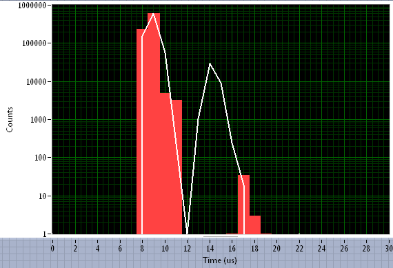

What we see is that when we monitor the time taken to read from a DMA channel from the FPGA, the distribution of our timings looks very much like the polling rate of the DMA buffer inttroduces a timing quantisation of 6 us.  Below is a histogram of our timings for reading (White line) and writing (red columns) the DMA FIFOs from and to the FPGA respectively.  It's a distribution which can actually play havok with out control loop.  Our entire loop rate needs to be 50us (20kHz rate) and taking a 6 us hit every now and then depending on how the DMA FIFO is behaving seems like a lot.  I have seen this 6us timing previously when I was benchmarking the DMA channels completely independently of our control software.
We timed this using a us Timer before and after the FIFO read.  Any variations in the execution time of this node will of course also be reflected here.  Our hardware is a PXIe-8115 with a PXIe-7965R FPGA card.
Even in cases where we are running behind in our timings (where the FIFO from the FPGA has plenty of data for reading) we never see the FIFO read executing any faster than 8 or 9 microseconds (let's say 8.5 us).
I had high hopes installing the "new" Patch which should apparently reduce jitter but it seems to have had absolutely no affect on our software whatsoever.
It is with this background that I was extremely interested in any changes in the execution speed of DMA FIFOs with the new Zynq architecture.
Shane.
PS I will state again that once you increase the amount of data being transferred so that the ACTUAL data transfer takes longer than the 6us mentioned here, each U32 sample sent adds 0.06us to the execution time of the DMA.  Tht's 1/100th of the minimum required time for a DMA read or write.

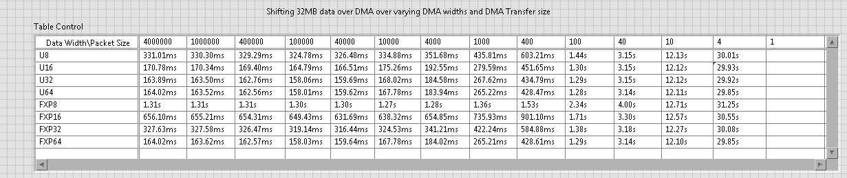

So I have a small benchmark VI which pretty much demonstrates what I'm getting at.  This is becoming a bit current because we're starting to look at the architecture for our next software version and the latency of the DMA transfers is biting us a little bit to be honest.  We MAY end up with a mixed approach of FP controls and DMA in order to reach our goals.  Nothing is certain yet.
But back to the benchmark.
I have tried to benchmark the DMA performance when shifting 32MB of data across DMA FIFOs of varying width.  I have implemented U8, U16, U32, U64, FXP8, FXP16, FXP32, FXP64 FIFos each with its own return queue so that I cen accurately benchmark the time taken for all the data to arrive on the FPGA.  I create an array of 32MB size (32M U8 or FXP8*, 16M U16 or FXP16*, 8M U32 or FXP32* and 4M U64 or FXP64*) to transfer and then send the data via DMA FIFO and wait for a response from the FPGA that all have arrived.  Subsequent runs then split this payload up into successively smaller packets and measure the overall time taken to deliver the content.  The inherent overhead of the DMA transfer thus increases rapidly as we decrease the packet size.  Note that the total amount of data* transmitted is constant for all cases.
This test was run on a PXIe-8115 with a PXIe-7965R FPGA card.
*Caveat: I know FXP is represented as 64-bit on the RT level meaning that an array of 32M FXP8 is actually 8x32MB in size but the actual DATA CONTENT is 32MB.  I still believe that the sriver should automatically choose the next largest FIFO size for transfer.  But this is just for the case where this may be changed in a future version.  The scaling seen between the FXP tests is solely due to the fact that internally the FIFOs are working with 64-bit width meaning that the FXP8 version is actually sending 8x more data over the DMA FIFO than the FXP64 version.
So we see for example that sending the data in packets of 4 instead of packets of 4M is overall 100 times slower for U8 and nearly 200 times slower for U16, U32 and U64.  An ideal (not achievable) scenario with zero overhead would yield the same times for all packet sizes.  What I would be interested in is seeing how the times vary with packet size for the newer Zynq systems.  Given the very low latency bus over which the DMAs are being transmitted, it should be feasible for the increase in overall time with decreasing packet size to be lower than we see here.
Once we get to packet sizes of below 100 the times tend to even out.  This agrees with previous tests I have made where sending 1 element or sending 100 elements or anything in between will take the exact same amount of time.  Thus, moving to smaller packets we are simply seeing a linear increase of the overhead of the individual DMA write calls instead of the data size itself being the performance determining aspect.
I include the VIs here in case someone might want to try this code out on the newer targets.  If the DMA transfers on the newer targets using the AXI bus for transmission could significantly lower the overhead for writing single elements to the DMA then this allows a very different approach for control applications which require small amounts of data to be exchanged as quickly as possible (like ours).
