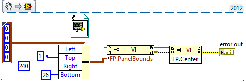

  I have a simple subvi, it has a string indicator embeded into the panel. I have the string fit to the pane. I am going to change the size of the panel to width 240 and height 24 then centerlize the panel. I found some code in the forum. If I don't put the string there, the code works perfect. But after putting the string, it will run into error.
And I call the subvi FP.vi in a main vi (main.vi).  The error is
Error 1 occurred at Property Node (arg 1) in FP.vi->main
Possible reasons(s):
LabVIEW:  An input parameter is invalid. For example if the input is a path, the path might contain a character not allowed by the OS such as ? or @.
Property Name: Front Panel Window:Panel Bounds
Any suggestion why this error?

I don't see a reference to the FP subVI in your image.  You need to have a VI reference going into the FP.PanelBounds Property Node.

Yes, I thought he was trying to call a subVI reference, though.
Anyway, I played around with the same VI's and I get the same error message if I try to use the same coordinates, but when I increased the bottom coordinate to a value of 26 then I don't get the error.

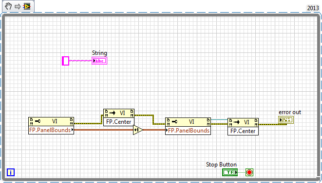

Here is a snippet that worked for me.
Message 5 of 10
Yes there is a minimum height for string indicators you violated that
Thanks for pointing that out. I just want to know how to figure out 26 is the minimum coordinate I should use other tha something else. Instead of hardcoding that, anywhere I can refer to so to get the minimum? Thanks.

Min size is a property of many controls.  it changes.  for instance, with a silver style string control its 37 pixels high with the default font size. ( it Makes sense, that it shows 1 line of text clearly)
By scaling to pane- the string min size is forced into the min pane size of the 1 pane panel (FP) so setting the height lower than the control could show 1 line of text clearly yielded an error.
Or, in other words, the error explaination could have been clearer when it was first implemented.
