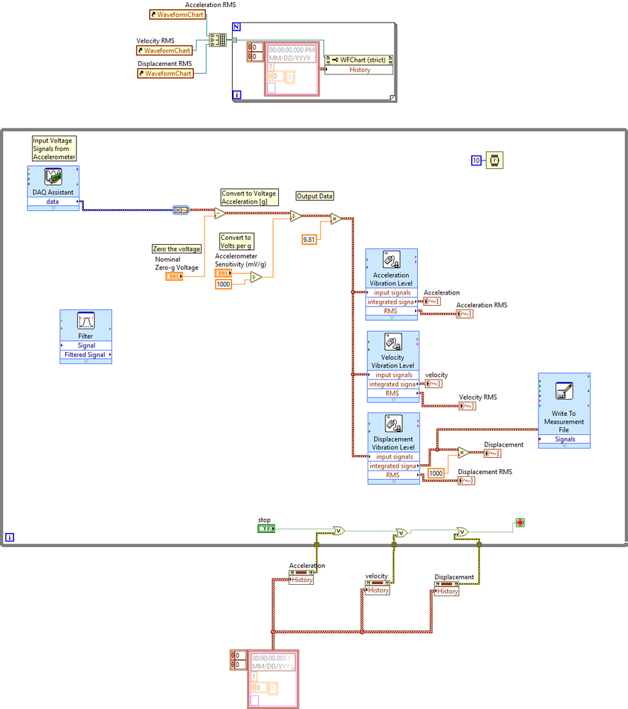

Thank you very much for your help, the DAQ that I'm using is a NI myDAQ, about the connection, it's well connected to analogue input channel ai0, the interface that I have for Labview v2020 isn't quite similar for your interface, as a choice, I have 4 choices for acquisition mode: 1 sample(on demand), 1 sample(HW timed), N samples, and continuous samples. when using the 1 sample on demand, it gives me a good result but I want to increase the sampling, where it comes to my question above.
Please find attached the file in 2016 Labview version
Cordially
Ali

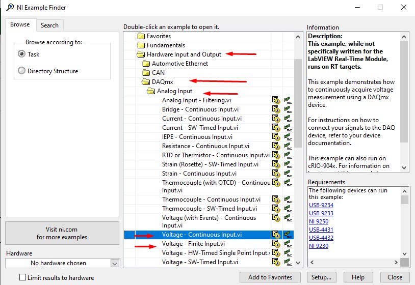

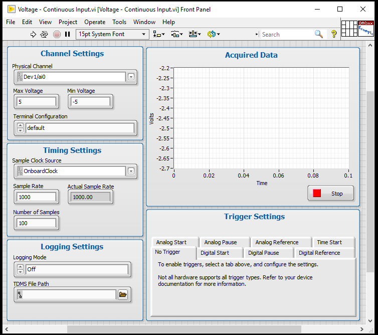

I would advise against using DAQ assistant and go with DAQmx drivers instead
Please use the example shown below from Help > Find Examples...
DAQ Assistant is like training wheels on a bicycle, it allows you to ride the bicycle and not do high-performance manoeuvres. Whereas DAQmx driver is the bicycle itself, once you learn it, it is up to you to decide how you want to use the instrument.
DAQ Assistant is easy to get started but won't take you far enough if the requirement quickly escalates. This is a great article to understand DAQmx for beginners - https://www.ni.com/en-us/support/documentation/supplemental/06/learn-10-functions-in-ni-daqmx-and-ha...
