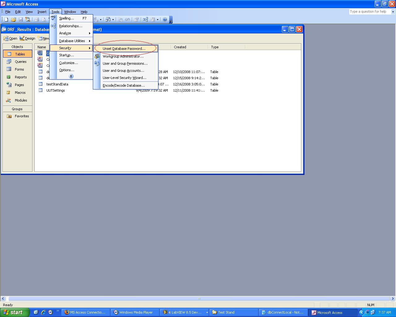

So I think I found a solution. It uses the db security rather than workgroup security:
I don't need high security or different access levels so this works fine for me.
Connection info:
Provider=Microsoft.Jet.OLEDB.4.0;
Data Source=C:\Code\Labview\SubVIs\Test Stand\DRF_Results.mdb;
Jet OLEDB:Database Password=1234;
The pertinent text is highlighted.
