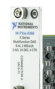

2.  To determine which cards you are using, look at the front of your chassis.  You will see multiple cards in the slots.  Each card has a model number as seen below.  Upload a pic if you still can't figure it out.  Or look at Measurement and Automation Explorer (MAX).
