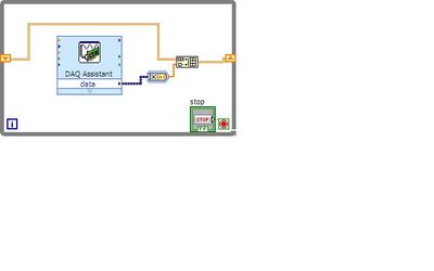

Use something like this:
But where the DAQ Assistant is, put your own DAQmx code (for something as simple as acquiring 1000 samples, DAQ Assistant is good!)
Make sure the Build Array function is set to Concatenate Inputs, also the Convert from Dynamic Data is set to 1D array of scalars- automatic (but this only matters with the DAQ Assistant)
I hope this helps!

hello everyone,
                      A special thanks to Er.Macaba, Your solution solved my entire problem.. I aslo thank others for their valuable information.. Though not now but at some other point of  time, they too may come in use..

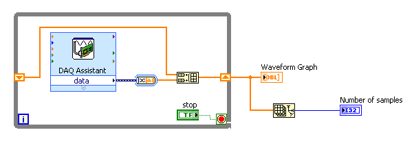

Try this too.
This is using A DAQmx. Using an Express VI generally eats a lot of memory
Somil Gautam

Dear Eng. Mark,
I tried to do you VI but the dynamic data converted to 2D array not to 1D array, please inform me about the proble, also i cann't find the waveform graph icon.
M. Abdelkader.
Message 8 of 20
(9,929 Views)
The waveform graph icon is the terminal for the waveform graph you drop onto the front panel.
For a 2-D array, change the properties in the dialog box you get by double clicking on the Convert Dynamic Data express VI so that it outputs a 2-D array.
You may need to change the Build Array function to Concatenate Inputs by right clicking on it.
(PS.  I see you were ultimately able to get your screenshot embedded, but it looks like you first tried by using Firefox to embed a jpeg.  That doesn't work because the file it points to is located on your hard drive which we can't access.)
