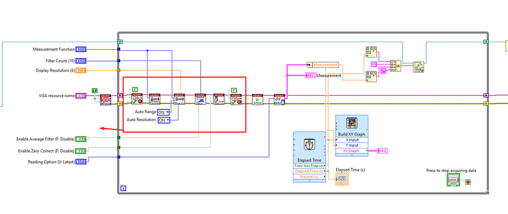

I have been working with Keithley Electrometer 6514 to acquire the current values using GPIB (KUSB 488B), and for that, I made a simple program using available drives and pellets. but I am able to get only 3 to 4 data points in a second, how can I increase the data acquisition speed? the VI made by me is attached here.

Thanks for your reply. here is the VI

Hi charnu,
a simple way to improve iteration speed would be to move as many init functions as possible out of the loop…

In short, to improve the speed, move all one-time configurations outside the loop, especially the ones highlighted below.
As Henrik guided, read the manual to see if there is special technique recommended to get the utmost performance from the instrument.

Thanks for your reply, I already tried moving all the configuration pellets out of the loop but it didn't help much. Please suggest any other way of doing it. Thank you.

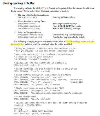

As per the instrument manual, you can leverage the 2000 measurement buffer to sample at the fastest rate.
