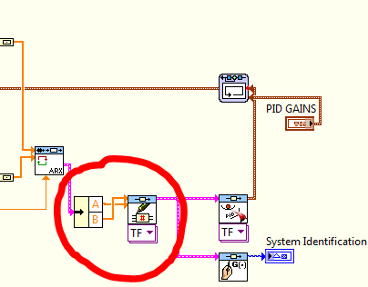

One last thing that I missed is that you are not properly converting your model from ARX model - this could certainly cause an issue.
24604iA43D792EEAB5F4A6

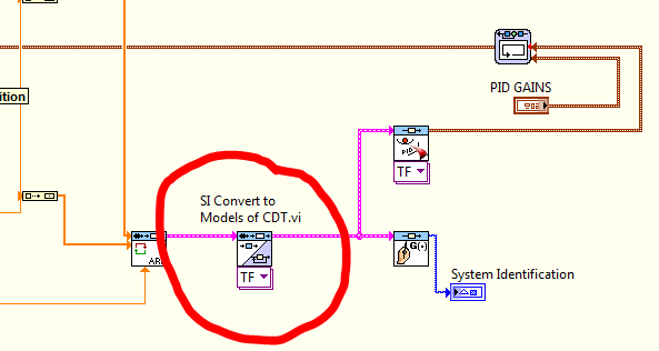

The correct way to do this is to replace the unbundle and the CD Set Data to Model and replace it with SI Convert to Models of CDT:
24606i53C44D0FC0380257
Please try this, even if this isn't the root cause of your issue, it is something worth changing as it could be causing other problems.
--Michelle
