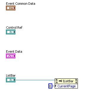

- Create a copy of the controls global variable used above in the VI, and set it to read the 'ListBar' reference. Wire this to the UserParameter terminal.
- Right click where it says, 'VI Ref' and select 'Create Callback VI'. Whenever the an execution is closed, this VI we have just created will be run.
- On the block diagram place a property node, wire the LisBar reference to it, select the CurrentPage property and write a value of 0 to it. This will effectively be the click on the first entry in the list bar which is normally your sequence file.
