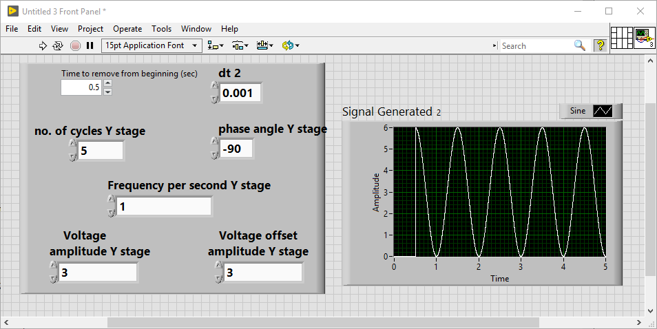

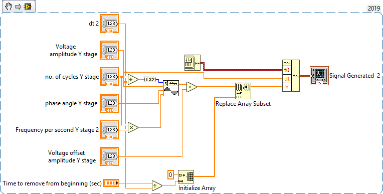

If I understand your issue, you're trying to create this waveform:
Spoiler
 Is that what you're trying to do?
Or is your issue only in trying to output to the DAQ hardware?
-joeorbob

No, I want the sinusoidal wave to start after 0.25 sec with amplitude ranging from 0 to 3, means start at 0 at 0.25 sec and reach 3 at 0.75 sec. And another waveform to start at 0 at 0sec and reach 3 at 0.5sec.
Actually now i solved the issue in my previous VI. where there are sample mismatch in the waveform coming from sine and cosine generator . Now after this modification the DAQ is able to generate required waveform
Thank You very much for your support.

Hi prasad,
Then you need to create such a waveform from two parts:
