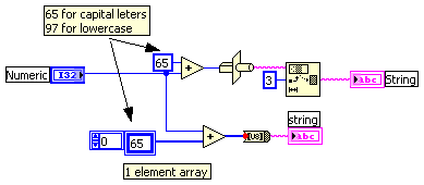

There's two quick ways you can do this by using ASCII codes:
Message Edited by smercurio_fc on 07-13-2007 05:56 PM
