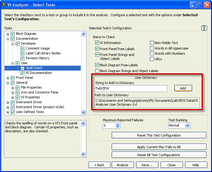

Add them to your User Dictionary.

Tay,
what version of LV are you using?
The VI Analyzer in version 2009 gives you the option to add strings to the spell check or completly replace the used dictionary. You can find the settings for this in the VI Analyzer configuration dialog for your VI(s) in Documentation >> User >> Spell Check.
hope this helps,
Norbert
