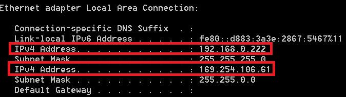

this is windows 7.  I have uninstalled all of the labview applications yet i still have the problem.  Perhaps it is not an NI problem.  I have attached the screen shot of the CMD ipconfig command

Why does the linklocal address not show? Can you scroll down or enlage the window?

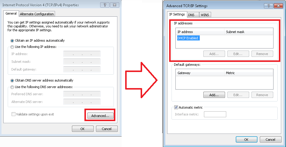

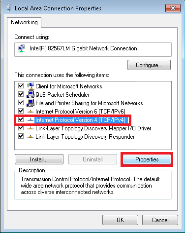

I believe he is referring to this:
Unfortunately I don't have many suggestions aside from checking in the "Nework and Sharing Center" in the Windows 7 "Control Panel".  Perhaps you have an extra virtual adapter installed.  Or your IPv4 on your ethernet adapter needs reconfigured.  [Although I would doubt this is LabVIEW related.]
EDIT:
What I mean by that, is check for additional network adapters.  If so, remove them.
Otherwise, check for weird settings such as a private IP address in here:

Here is another image showing the link local.  I would agree that it probably isnt an NI issue at this point.

However, you should be able to manually see all the IPs within your IPv4 settings:
But I wouldn't mess with this unless you really know what you're doing and/or it is giving you horrible, unusable issues.
