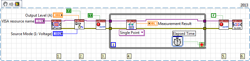

So I took a few minutes and came up with a quick sample program using the Agilent instrument drivers I already linked to.  The driver uses the flow commonly seen in LabVIEW of initialize, configure, measure (in this case output), close.  The example will take the following steps.  The labeled numbers in the image and program match these steps.
  1. Initialize the b2901A
  2. Configure it to output a current
  3. Enable the output (basically turn it on).
  4. Take a software timed voltage measurement for 10 seconds.
  5. Disable the output.
  6. Close communication.
To use you will have to set the VISA resource to your instrument and your output level.  Then you should be able to run the code.  Let me know if you have another questions.  I have found the B2901 to be a very powerful instrument.  In the only few months we have had it I have found several uses for it that were outside of what we purchased it for.

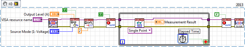

There are several things that could cause that.  My guess is you are hitting a compliance limit.  This is a safety setting in the instrument.  When you tell it to out put a current it will output that current and go to whatever voltage it needs to in order to do that.  There is a setting called compliance that prevents it going above X voltage and will limit current if necessary to stay under X voltage.  My guess is that this is what is causing your issue.  You can set this with the Configure Output Protection submit.  Another option is there is a safety setting where a safety switch must be connect to the system if it the voltage is going to be above 42V (I think that's the level).  So if you are above that you will need to check the manual and see what has to be done to set that up.  My tests are low voltage so I have never looked at that.    Let me know if you are still having issues.

so that worked but i cant go above 5volts now it seems to be that the lowest current source range is the problem. It is automatically set at 3A when it is at 1mA in manual it works but i dont see which sub vi has this setting.
Message 8 of 10
(6,077 Views)
i found it thanks for your help
