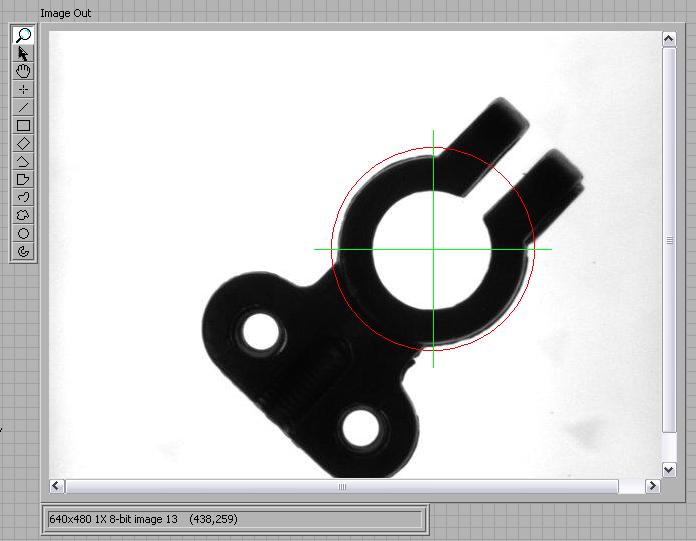

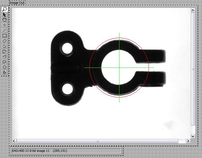

i have this situation, as the first image is centered, the crosshair is drawn correctly.
as the item rotates, the crosshair is also drawn, but it is not drawn correctly. can someone tell me what i can do to fix it?
Here is what I have.
This is a good crosshairs drawn..
This is BAD
This is what I need to have. (YELLOW LINE)

Use Measurement System.Angle (deg) which is delivered from IVA Coordinate System Manager.vi. This will give you the angle. Use it for calculation of the coordinates for your cross mark.

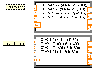

i am sucessfull with 1 line but not 2 lines.

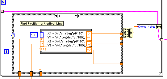

This is because you have not changed anything in the first case of the case structure which deals with the position of the vertical line. The following change should do the trick:

yeah, the vi i sent wasnt working for case 1.
but i have fixed it and didnt submit it.
i did (90-deg)
Thank you for your help!!!!
