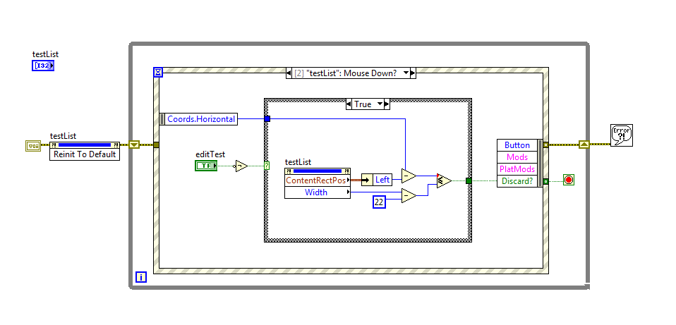

Personally I would use the mouse filter event on the list instead of the value change on the boolean:
Message 6 of 11

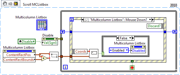

I just use the disable property and the Mouse Down event myself.  You can even scroll grayed out controls using this method.  Only discarding clicks still leaves other methods of editing available.
Edit:  I am probably old-fashioned, but overlapping controls on the FP can be a CPU burner in some cases (graphs especially) as LV becomes a bit too aggressive in repainting.  Might be better in newer versions, I am just out of the habit so I don't know.  Always available as a fall-back solution, but I personally would be careful using it as a go-to method.  While it may be ok here, pretty soon if you start doing it everywhere things get out of hand.
And while I am at it, I have to think about the appropriateness of the scrollbar being disabled with the rest of the control.  Not sure I like it.

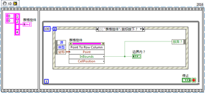

I got a simple solution here.
It doesn't disable the table, but the user cannot edit the cell because mouse down action is discarded with in table area.
and the scroll bar works fine.
and it doesn't involve any constant number parameter, using point to row column method to determine whether mouse is in table.
