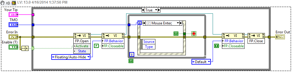

  I am looking for a way to show a tip or note on the screen. I know we could set the tip strip on a UI so when the mouse enter the UI the tip will appear. But I want to know any way to show something like that on the screen without requiring the mouse entering the UI and make it disappear in some seconds or when the mouse click any where. This just like a dialog but wihout out the OK or CANCEL BUTTON and will disappear by itself after some times or by any action (keyboard or mouse).

You could even play with the transparentcy setting to fade in/out (Not shown)
Thanks a lot. Looks great. I wonder if any way to attach the code.

I get asked that a lot
Follow the link to see how difficult it migtht be for you to re-create that code
That png has all the code in it!Smiley Wink
