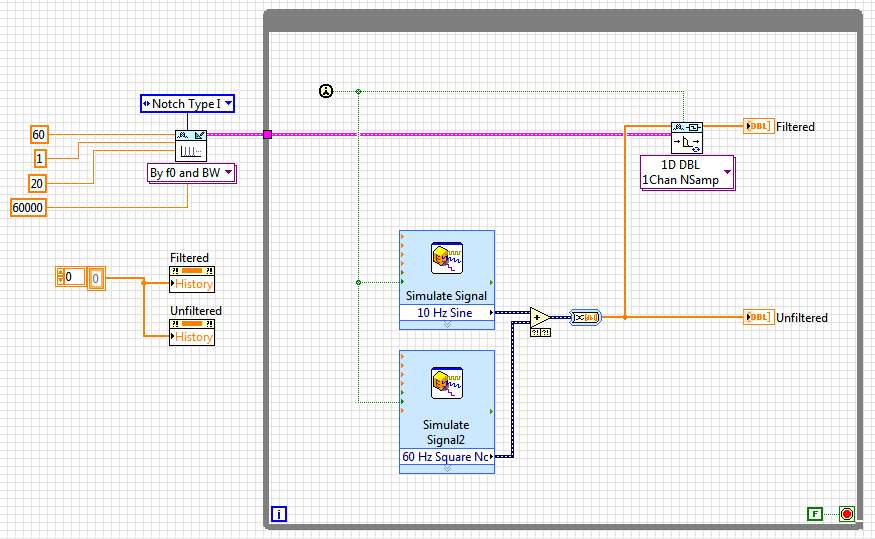

The one VI you referring to defines the comb filter you want to use.  The inputs are as follows
Sampling Frequency = rate at which the data you are going to filter has been sampled at
f0 = The spacing of the notches in the spectrum
Df = the spectral width of the notches
Ab = the average depth of the notches
For example, you could make a comb filter to filter out 60 Hz and all harmonics of 60 Hz.  The parameters could be as follows:
Sampling Freq = 60000 Hz
f0 = 60 Hz
Df = 1 Hz
Ab = 20 dB
I simulated a 10 Hz Sine Wave with 60 Hz Square Wave noise on it.  Below are images of the block diagram and the front panel.
