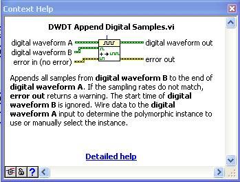

The warning you getting because both of your waveform sampling rate was not matching find the attached Vi and Help.
