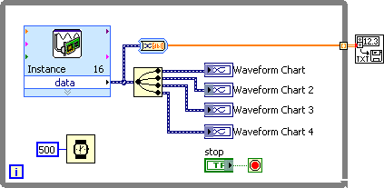

The picture below shows a very simple acquisition of multiple channels and a file save when the loop completes. The DAQ Assistant is set up for multiple channels (four in this case) and it does a single scan every 500 msec.
Message Edited by Dennis Knutson on 04-24-2007 12:36 PM
