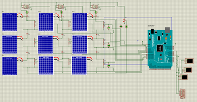

I'm new to LabVIEW i have created a 3x3 pv array in proteus 9 voltage and 3 current sensors are attached
i want to acquire the data from the sensors and send it to LabVIEW for further computation.
i have no idea on how to acquire the serial data from arduino mega into labview and use it for computation.
help me out at the earliest.

Hi Stanwin,
  • Connect the Arduino to your computer using its virtual COM port (aka USB connection).
  • Then write an Arduino sketch to collect the measurement data and send it to the serial port.
  • Read the COM port in LabVIEW using VISA functions…
(930 Views)
This will be very useful - https://labviewwiki.org/wiki/VIWeek_2020/Proper_way_to_communicate_over_serial
