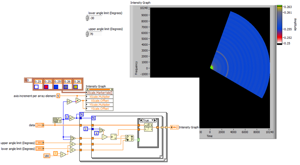

Array indices are always non-negative, so you need to apply an offset such that e.g. index 1024 corresponds to zero. For display, you can change the axis offset accordingly.
You really (really!) should adapt my second example where you iterate over intensity pixels!!!
Message 15 of 17
(1,210 Views)
@sheshu9a1 wrote:
Yes your code works the way i want to some extent and i really want to thank you for that. but how do I represent the negative axes on an intensity graph . Please check the VI then I hope you will have an idea what i am talking about. Thank You.
No, just no!
  • First of all, unless you really want to zoom in later, you don't need an array that is larger than the number of displayed pixels!
  • Obviously, you don't understand my code. It is pointless to create a 2D array that contains 25 times too many elements and most elements never touched. Changing the multiplier of the axes simply changes the axis markers such that one array element has 5 units. No need to make each dimension 5x larger!
  • Here's a simple rewrite, allowing you to define the starting and ending angle. (yes, the array is still way (way!!!) too big, 2048x2048). You could tune the display to the actual pixels of the graph (not shown).
  • Many things could be tuned significantly (not shown).
Message 16 of 17
(1,207 Views)
