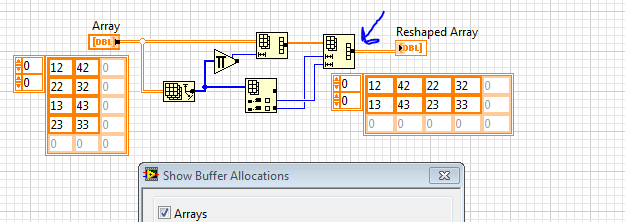

Reshape transposing rows and columns
(Note: I bet the array buffer allocations aren't necessarilly real)

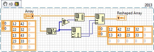

Jeff, all you did was a Transpose 2D Array.  Look at the example closer.
Here's what I came up with really quick.  It is scalable.

thanks. What is that double orange block on the output of the for loop?
Message 6 of 9
(4,961 Views)
I told the FOR loop's output terminals to "Concatinate".  Right click on the terminal and go to Tunnel Mode->Concatinating.  That was introduced in 2012, so if you have anything older, we will need to have some fun with shift registers and Build Array.
