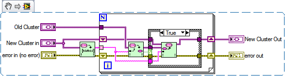

This is a pretty standard problem of how to convert old versions of clusters.  Here's the guts of a nice clean approach using OpenG VCluster tools.  The "New cluster in" control is fed a default cluster of the new version.  The first VI builds a list of the element names from the variant.  The second one retrieves the value in the "Old Cluster" with that name, if it exists.  If so, it assigns the value.  The false case is empty.   I don't recall testing this against clusters-of-clusters or arrays-of-clusters etc.  I wrapped this subVI in another that was specific to the new cluster's typedef.  It fed a default constant in, then converted the output back to a cluster, checked for blank required fields and popped up a dialog if necessary.
I've also goofed around with flattening to XML and seeing what happens when you try to unflatten to a different cluster. I think what I remember is that the unflatten depends on the element's order in the cluster and the data type and not the name.  EDIT: you can unflatten to a cluster regardless of the label text of each item, but any mismatch of order, type, or number of elements will throw an error.
Ben's link shows an excellent example of the useful strategy of typecasting references "to more specific" and checking the error out to test the type of a control.
