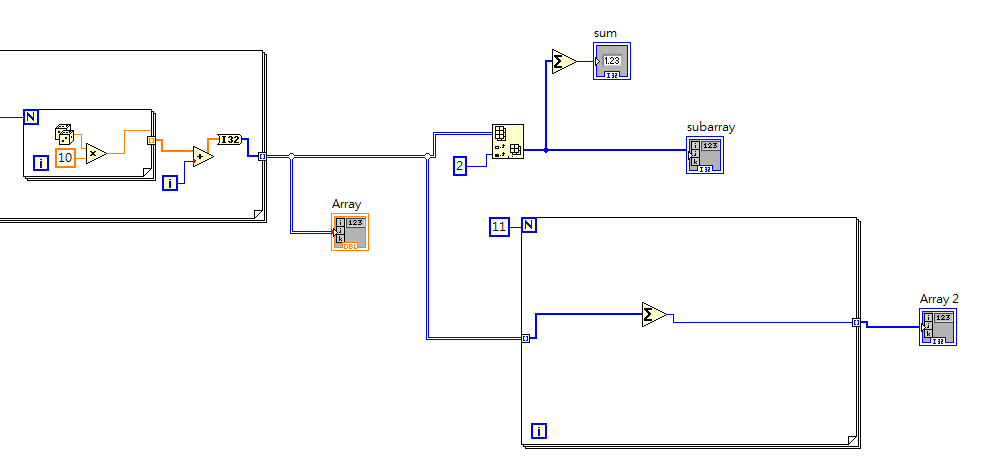

here is the block diagram of vi. I tried to give the solution.
here remains two problem:
1.It seem theat I don't need the Shift Register, how can I use it ?
2.Can I change row-major order auto-indexing to column-major ?
This is just a picture of part of the block diagram. It is usually better to attach the actual VI.
If you don't have to, you don't need to use a shift register. It would be a good exercise to write an alterative version of the code that uses a shift register. Try it!
You can transpose the array before autoindexing.
Also, don't wire N if you are autoindexing on an array (except for rare cases).
Also try to eliminate coercion dots. Some of your indicators have incorrect representation.
I second what Christian said.  If you have found a solution that does not use shift registers, there is no need to use them.  This was merley an example, a suggestion of one possible solution; however, if you are unfamiliar with shift registers, or their use, it would be a good idea to become accustomed to them.  They're used everywhere, and are very useful.
