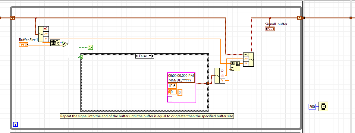

The intention was to make a program that would asynchronously generate multiple different signals into a buffer.  Then, something would consume the buffer - a daq output, signal processing, etc.  I created a dummy consumption that just takes 1% off the beginning of the buffer.  Whenever the buffer gets below the specified size(s), more signal will be added to the end.
I ran into a problem where the Array subset function is truncating the end of the subset sometimes, so I stripped the program down until a bare minimum of code exists to cause the problem.  It seems to be memory usage or allocation related.  Maybe I'm doing something that I shouldn't, but it seems like a labview bug.  In the block diagram, I have a note that shows a waveform wire that goes to a case statement.  Just removing this wire causes it to function properly as can be seen by the consistency of the waveform on the front panel.
I'm using Labview 2014 (no SP1)
I'd appreciate any insight.

This program (as posted) doesn't actually do anything useful.  It is a stripped down version of a real program just to demonstate the array subset "bug".  Everything before the index value of the array subset just goes to the bit bucket.  With length unwired, the subset should be the remaining part of the array.  The problem is, sometimes the end of the array is truncated also.  Simply deleting that wire as indicated makes it function correctly.
The flat sequence isn't really needed, but it does really help visually demonstrate the problem if you add a frame in the middle with a ~200mS delay.  You can see a new waveform added when the buffer falls below 1M samples, then a little bit disappear from the end after the subset is taken 200mS later.

What I'm seeing is truncation of the end of the array on Signal2, which can be seen on the Signal2 buffer waveform graph as a change in the spacing of the signal pulses immediately after the buffer initially fills up.  Can you confirm that you're able to see the same problem?  I had a coworker try it here and it had the same problem.  We're both on LV 2014 without SP1.

Yes, there might be a compiler error, reusing a buffer it should not.
If you insert an "always copy" as e.g. shown in the picture, the problem disappears.
I am not sure why you are constantly gettting and building all these waveform components. If you would operate on arrays (just build the waveform for the graph), it seems the problem disappears too.

I suspected that building arrays back into waveforms makes it less efficient, but I had several different sub vi's for building all different types of waveforms parametrically, and figured the waveform data type was best.  I just wanted some sort of confirmation that it's either a compiler error or that I'm doing something wrong.  Even though it's inefficient, I would think it should work.

As a workaround, use the always copy for now. I'll try to involve somebody from LabVIEW R&D to get the final word.
