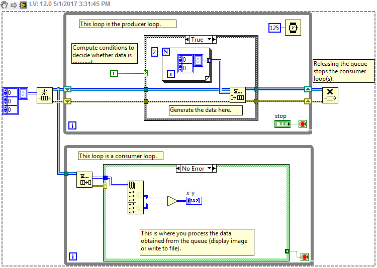

Another possibility, as I mentioned.  Using a producer/consumer design pattern, grab two images and build a 3D array with it.  Pass to the consumer loop, do the math, and display or write to file.
