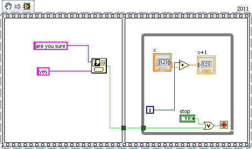

When the Yes button in the dialoge box is pressed ,you can wire the True value to a Boolean OR and the other input of the OR to the FOR LOOP Stop.
Seee attachemnet
Nghtcwrlr

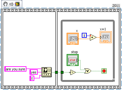

here there are two buttons on the message box. If you press yes, the second  event case is executed. if you press No, the program stops.
Hope this is what you wanted
Nghtcwrlr

Have you tried my last example?  Even if you press button X OR the window closing X, the program stops.
Actually what are you trying to to? can you be more specific in your final goal?
