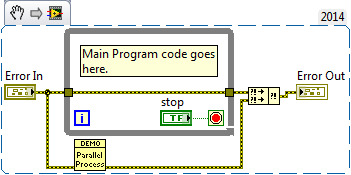

     One way to have, say, 5 such Processes run in parallel is to stack the 5 Process VIs vertically, wire all of the input Error lines together, and put them in parallel with the main Process.  Here's a simple example:
Here the main loop of the Main Program and the Parallel Process start at the same time, and in order for the Main Program to stop, the Parallel Process also has to stop.
     One difficulty with this simple way of starting Parallel Processes is controlling when they start.  In this example, they start when I branch the Error line.  Note that I couldn't put the branch inside the While loop, since the Loop couldn't continue until the Parallel Process ended.  But what if I wanted to start it after the While loop ran, say, 3 times?  To do this, you put code wherever you need it to run the Parallel Process asynchronously.

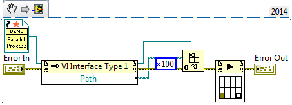

     Here's a suggestion for starting the Parallel Process that doesn't rely on wiring a Path into Open VI Reference.  Start with a Static VI Reference, and Browse for Path until you find the Parallel Process VI.  Next, right-click it and change it to a Strictly Typed Reference -- you need this to get the Front Panel connector information.  Now put down a Property Node and wire the Static Reference through it.  The Node should become a VI Interface Type ? node.  Choose the VI Path property, and wire that to Open VI Reference, with the Static Reference (strict) type wired in at the top.  Be sure to wire the Option for Call and Collect (0x100) or Call and Forget (0x80), as you require.  Finally, wire the reference to Start Asynchronous Call.  Here's what I mean:
This, now, you can "package" as a sub-VI (I named it "Spawn Parallel Process").  Such a sub-VI is very flexible -- you can place it wherever you need to in your Main program, and when it executes, it will "spawn" (start running as a Parallel Process) the routine "Demo Parallel Process", and will exit immediately without waiting for the Parallel Process to do anything.  Thus you could put a (single) call to Spawn Parallel Process inside the Main program's While loop and it would allow the loop to continue executing (unlike putting the Parallel process itself inside the loop).
