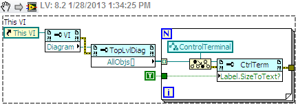

If you have scripting enabled...
And do use application font or system font in the future to avoid that pain.

This worked for me.  Yours didn't :(.  I didn't try to do it from outside the VI; maybe that's why.
Jim

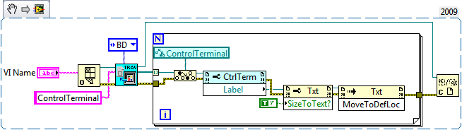

I traverse myself:

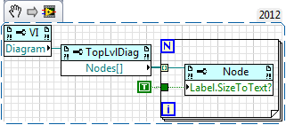

Yeah.  I imagine that a clear errors would be needed for nodes with no label

@Darin.K wrote:
I traverse myself:
I usually just have other people walking all over me.  Now I don't feel so bad.  Smiley Happy
