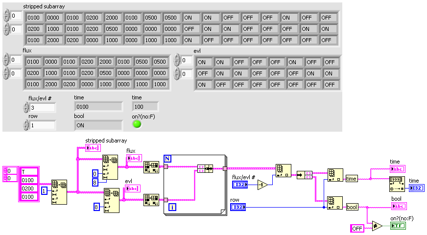

looks like you are reading the data vertically? from your statement...and you want time/bool with each flux#,evl# respectfully
Message 5 of 8
(3,469 Views)
Message 6 of 8
(3,462 Views)
see attached PNG file
Message 7 of 8
(3,448 Views)
