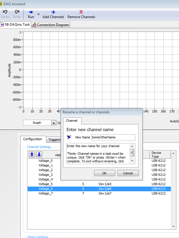

Possibly you should consider using the DAQmx Read N Channel N Sample 1D Waveform instance.
The Waveforms take the Channel Name attribute and automatically apply that to the plot name when graphed.  You can even assign the Channel Names with the DAQmx Wizard.
