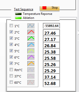

automatically turn on/off channels graph or front panel
does anyone know if Labview is capable of selectiing what channels to view?
for instant during ablation testing. i would not like to select the last 3 channels
but during temperature response. i would like to see all channels.
is it possible or i have to manually click it on the front panel?
thank you in advance.

Use a property node to 1) set the "active plot" (the plot you want to mess with in the following properties) and then 2) set plot visibility.  As long as you know which plots you want active, it is simple programming from there.
