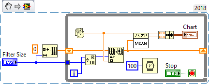

I'm not sure what you mean by the "cost of having to rebuild the array upon each iteration".  Build a "ring buffer", an array of length 10, pre-initialized to 0.  As the i-th point comes in, it is stored in array position (i mod 10) (use the Remainder on Quotient/Remainder) and you return the mean of the Array.  Here's a Snippet demonstrating its effect on a random number generator --
