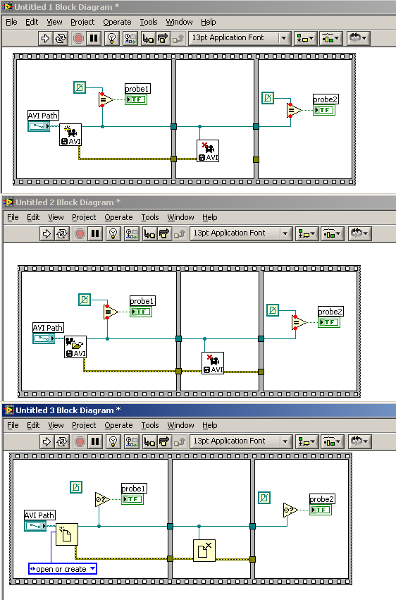

I thank you for the idea, but I'm afraid it does not work as I wanted.  The attached image shows 3 examples illustrating my point.
In the first example (untitled1), "IMAQ AVI Create" is used, and both probes remain false.
In the second example (untitled2), "IMAQ AVI Open" is used, and both probes remain false.
In the third example (untitled3), "Open\Create\Replace File" is used, and the "Not A Reference" primitive is false for probe1 and true for probe2.  Note: if I use the "equal to Not A Ref" method for the third example (like for the first two examples), I get both probes remaining false as well.
I'm looking for a way to replicate the behavior of the third example for AVI file references.
