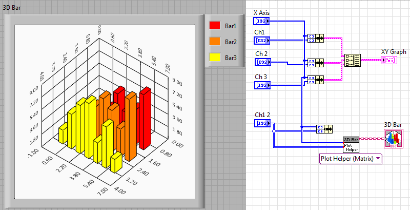

Please see the attached vi. Each bar shows value of all channels and I want it not to be represented in a stack format. Any suggestions?

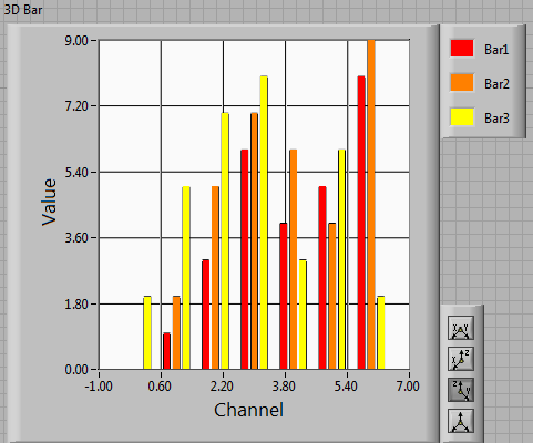

You can view the 3D dimension in 2D. Shortcut->Visible Items->Projection Palette

Thanks I did not know that 3D could be changed to 2D. Bar 1, Bar2 and Bar 3 are repeating in groups for different values and the requirement is to only show it as channel on X axis and their values would change along Y axis. The width of bars is not of concern. Did you do any other change in the code? When I change to 2D I see a stacked representation of the channels/Bars.

The 3D Bar has 3 mode: detach, group and stack. What you want is group mode. Check it out from Shortcut->3D Plot Properties->Bar (page).

Seems like 3 D bar graph still does not help achieve the display format that is needed 😞 Are there any other suggestions?
