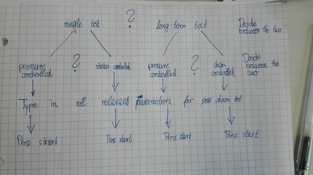

So here is my desired scheme. You're right, if I but a while loop around the event structure it prohibits the programm from closing itself after oping an event. But then it never stops running and I have to stop the programm by hand, type in the parameters and press 'run' once again by hand. But anyway thanks for the quick response and all the keywords to investigate.
Gerd, after you've seen the scheme what would you advice me to look for precisley?

That doesnt really change the advice given - use a producer consumer, and put your event structure in a while loop.
What do you mean you have to manually stop the program? Even with the event structure in a while loop, you can programmatically stop it if that is the behavior you are looking for. Use user events - in your consumer loop, once the test process is complete, fire a user event that the event structure is registered to listen to. When the event structure receives that event, stop the loop. If you check out the producer consumer template, this is all there for you.
