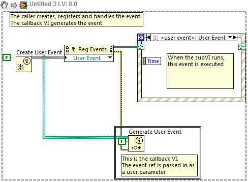

@labmaster wrote:
I tried to realize it by using some temporal variable which was just initialized before using it.
But I believe there is a simple method to check if "eventstatus" is OK.
Can you suggest how to use callback event in simple or update my code?
I don't know if you would consider this simple, but you can create a user event in the caller and register for it, then pass the event reference to the callback VI as the user parameter and generate the event in the callback VI. This will give you an event in the main VI when the callback VI runs. Make sure you register for the user event before you start the callback VI to avoid a situation where you miss the event.

Thanks tst,
Hard to understand your suggestion for me but I would like to understand it.
Can you explain it in detail with an example? I couldn't find some good example in this field.
