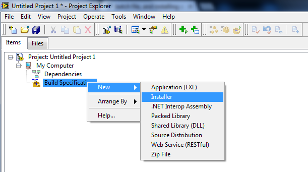

Creating an "Installer" build specification will do that automagically.
Message 2 of 12
(5,963 Views)
To clarify the "automagically" operation
Then you have to set up the properties to your installer. It's very similar to the way you set up your .exe, but with different options (of course). I mean: the procedures are similar.
Regards
Mondoni
