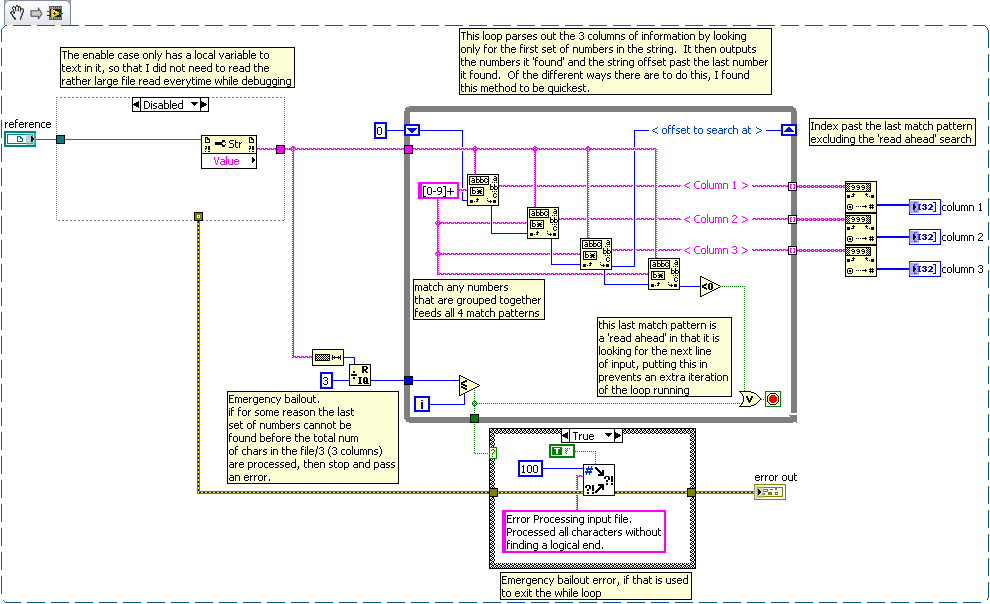

There are a ton of ways to do this.  I realized very quickly how large your datafile is, and I think this method is one of the quickest ways to parse your data file.  This assumes there are always 3 columns of data in the file and that the number of rows in a file is not known prior to reading in the file. If utilizing the snippet directly, I had to cut down the number of elements saved as default in the text string in order to upload the snippet.
Good luck,
Paul
When converting the selection to a snippet, it made the local variable a value property node plus required reference.  If you are not using the snippet directly, in the disable case is your file read to the text string indicator.
