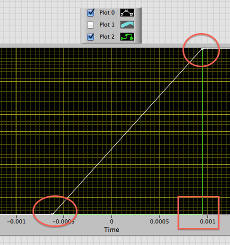

hi johnsold
i have changed my step function is not quiet working the way i want ,when i change the two variable controls for number of points and final value  ,the graph starts before it gets to zero which i don't want.
 i want it to start from zero at all time .
would you be kind enough and have a look at the vi and give me some feed back.
thanks
Message 26 of 47
(3,095 Views)
The issue with the graph starting before zero has two components. One is the plot interpolation. By changing that you can make it look as though the plot starts after zero with the same data. In the image below Plot 0 and Plot 2 have the same data. The highlighted ovals show the only two data points visible in this expanded plot near zero. Ther highlighted rectangle shows the stepwise interpolation of Plot 2.  The difference is the interpolation method.
The other issue is that the way you generate the data you do not always get a point at t = 0.  Since your algorithm assures that all values are zero for t < 0, why bother calculating them? Start the calculation with t = 0. Before plotting create an array of all zeros (Initialize Array). Then use Build Array to combine the block of zeros with the calculated data for t >= 0. That way you will always have a data point at t = zero.

Hi lynn
i got my vi running smothly now thanks for for your time may god reward you with more knowledge and wisdom.
