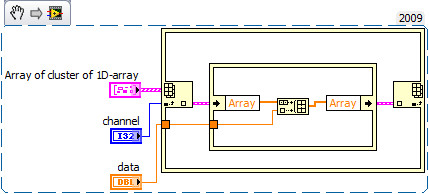

Hi Munna,
you can do it like this:
(Using InPlace structure…)
Message 7 of 21
(5,001 Views)
Dear GerdW,
Thank you so much for your reply.
I understood your Sample VI.
My biggest problem is, I don't know how to make that table to read Bytes from File (as per time intervals). Please give me some idea about this.
