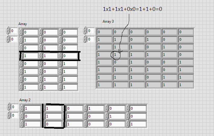

Ok here my question, how do i do this?

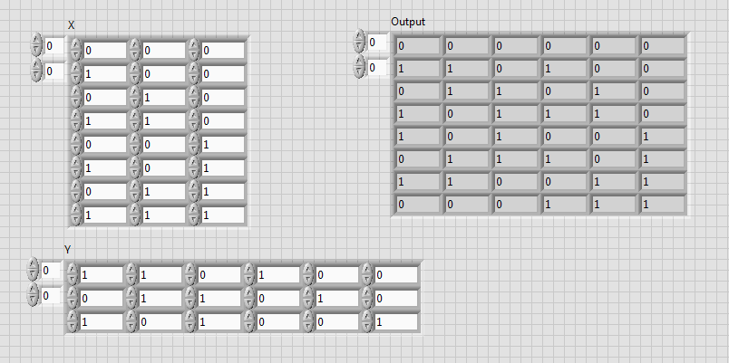

Below is the corrected table of the previously posted table:

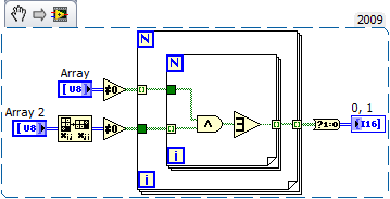

to end this nearly endless discussion (with bad problem descriptions): Why don't you just program what you have written on your frontpanel comment?
Like this:

How is this "NEW" version correct?
Look at row 4 of table X.  It is 1 1 0.
Look at column 2 of table Y.  It is 1 1 0.
The math would be 1x1 + 1x1 + 0x0 = 1 + 1 +1 which equal 2
Your output table of row 4 column 2 says 0.
Your math just doesn't add up!

GredW, the program is still incomplete, it only works for the first three input rows(x). The outputs for other rows are incorrect. Please see this-
I think your program needs only few modification. thanks
RavensFan- the output result is correct- The math would be 1x1 + 1x1 + 0x0 = 1 + 1 +0 which equal 0 (since in modulo-2 addition 1+1=0)

Where did this "modulo 2" stuff come from?  You never described that in your earlier messages.
Take the cross product.  Then use the Remainder output of the quotient Remainder Function when you divide the array by two.
Or just take the array and AND it with an array of 1's of the same size.
Done!

RavensFan- i didn't clearly understand your solution, could you perhaps attach a screenshot?
thanks,
susan
Message 36 of 40
(3,415 Views)
Accepted by topic author sumalama
Both ways shown.
