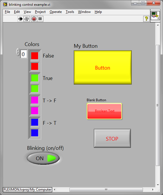

I want to use the blinking property of a button, to remind the user that the application is in some state.
I know that I can make my own timed loop to control the colors and blinking time, and that is what I am going to make.
I also know that I can set the application ini to use other blinking colors.
But I noticed some strange behaviour of the Silver Button Control.

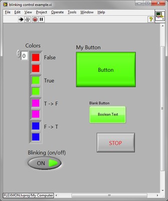

When I use the blinking property on the standard buttons, the button blinks yellow background with red text.
When I use the blinking property on the Silver buttons, the button blinks with a yellow border, red backround and red text, causing that the text is badly visable.
I would expect that the blinking colors are like the standard buttons, so yellow background and red text (or other if you set it in the application.ini)
The colors are used wrong for the Silver buttons.
I think that this is caused by the silver buttons that has more panels in it's control (the shiny panel and/or border), and text. A standard button has only the background and text.
So instead of using the blink property, I have to make my own timed loop to control the colors.
My question: Is the normal (correct) behaviour?
