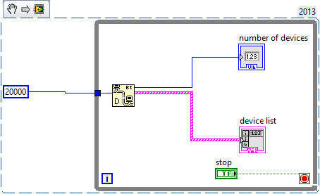

I want to use bluetooth communication in LV 2013. in first step I want find other bluetooth machine in my local.
I use this Function buut it doesn't find any bluetooth device. I turned on my phone bluetooth but LV cannot found that !!
Thanks.

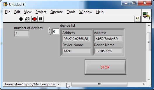

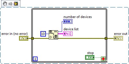

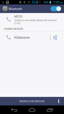

ajapyy
did you try to Decrease your Time Limit  i made my time limit (ms) is 10ms and put it inside the loop and it works perfectly . also make sure that your mobile bluetooth is dicoverable..
Note:
The optional input parameter, time limit (ms), specifies the length of Bluetooth inquiry. The default value is 10 ms and the maximum value is 30 s. If time limit is less than or equal to zero, the function returns a list of installed local Bluetooth devices.
Note: Bluetooth discovery is a slow operation because of the communication involved. A Bluetooth device address is a fixed address that is usually printed on the actual device and you can query the address from the device control setting. This address is unique to each device. If you know the Bluetooth address of the specific device you want to connect to, you can skip the discovery process and use the Bluetooth Open Connection function to connect to the device directly.
