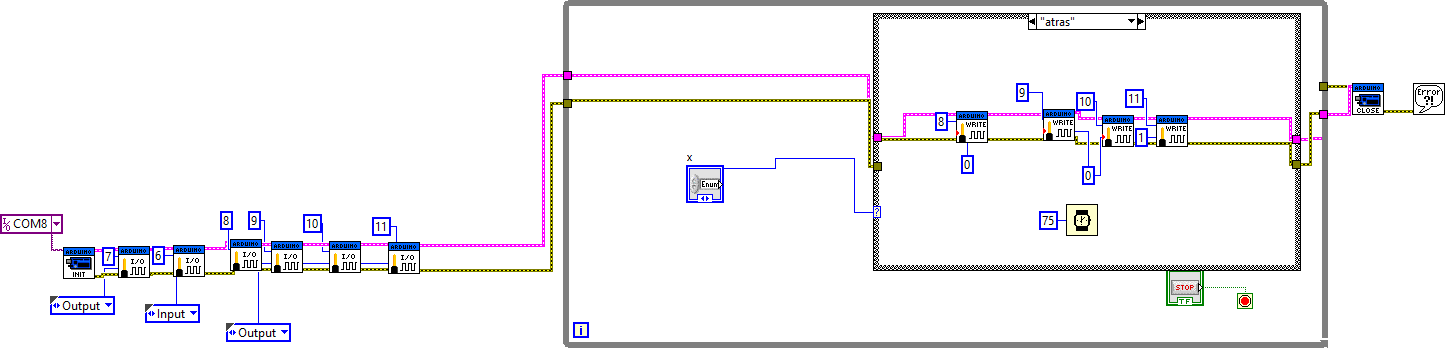

i need conect the bluetooth hc-06 in labview to controller my arduino but doesnt work 😕 this is my codee.png

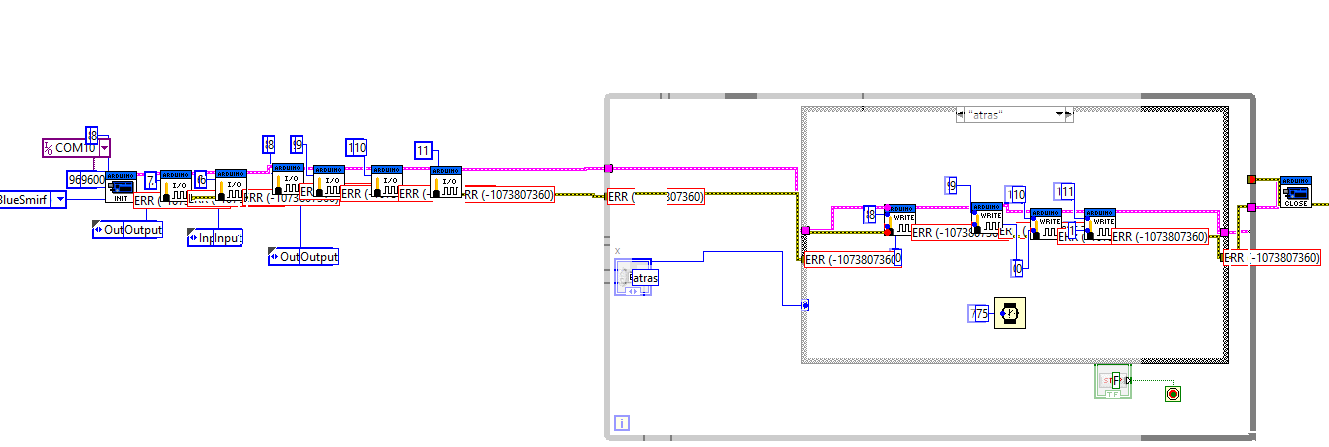

and this

Sorry bro ,my problem is i cant conect the bluetooth in labview to controller the program and i dont know how i conect the bluetooth can you help me ? How i can controller my arduino whit bluetooth

Obviously you can't connect, otherwise you wouldn't be asking the question.  The picture shows the error occurring on the very first subVI.  But perhaps the description of the error code will give a little bit of a clue why the connection isn't working?
I don't use bluetooth, so I have no experience.  But looking at your pictures, you have Com8 on one picture, com10 on the other.  Are you sure you should be using a serial port as the name for the connection?  It's possible that your device creates a virtual serial port, but it's also very possible it doesn't.
How does your bluetooth device show up in Windows device manager?  How does it show up in Measurment and Automation Explorer?
