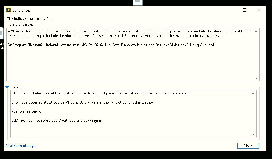

Now we want to make this library part of a large application. The interface is built into the subpanel. In the source, everything works.
But when we compile exe we get error 1502

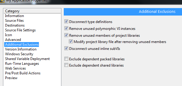

I checked all the boxes, but it doesn’t help
I added the ALL library to "always include", and this does not help.

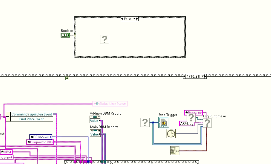

If we enable "enable debugging", compilation is successful, but the program is broken.
When we connect through the debugger, we see in the code that all the routines are "lost"

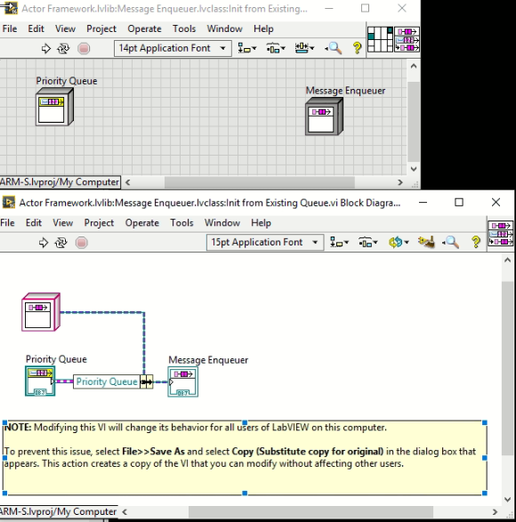

Does the VI "Init from Existing Queue.vi" have a block diagram?
What are the step settings for that VI?
Perhaps you shouldn't tag all options?
Tagging to remove\disconnect items usually doesn't help if items are removed\disconnected...
You shouldn't need to do all this, if you use the library as nornmal VIs. Is there any dynamically loading involved?
This is standard Actor vi, and it's OK.
What you mean with "step settings"?

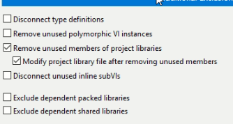

You are right!
this combination works
