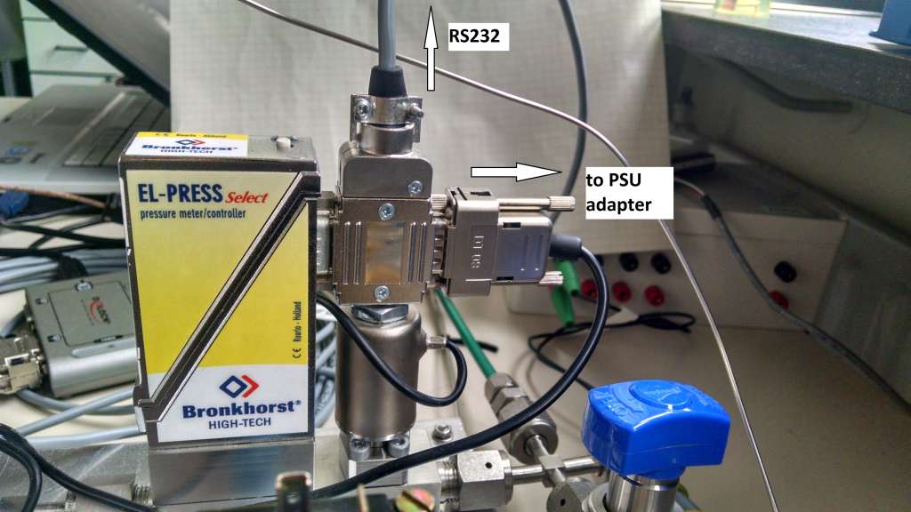

Contact Bronkhorst, you need a special cable which connects the MFC to a power supply and additionally it has a RS232 cable connection. An RS232 cannot power your device alone.
Have a look at my setup (it is a pressure regulator, but the same applies to a MFC):
Message 2 of 11
(9,064 Views)
Thank you so much and picture explains very well..:)

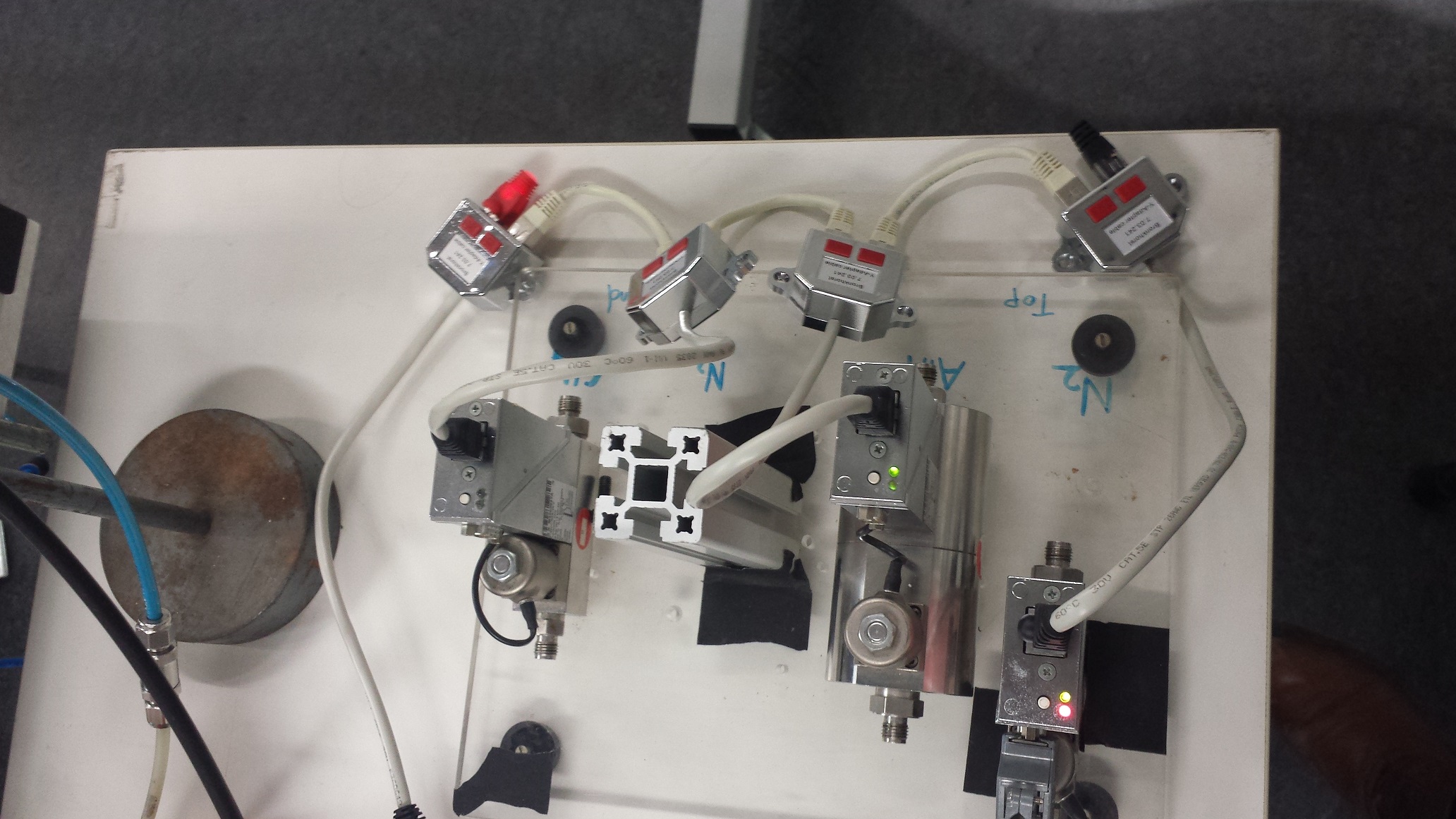

Hello!
I'm having a similar problem. I built a flow bus (see picture), but the MFC on the left doesn't get any power. I am not sure what the problem might be, it used to work some time ago in a different system.
Can anybody offer me any help?
Thanks and best regards!
Message 9 of 11
(8,737 Views)
Is this flow controller identical (type + cabling) to the other MFC which is in the right lower part in the photo? I see this other MFC is powered up (LEDs are lit). Did your try to connect the non working MFC to the cable which is connected to the working one? If it works there, you have some cabling/connection problem. If it does not work there either, contact company Bronkhorts for troubleshooting/service/repair.
